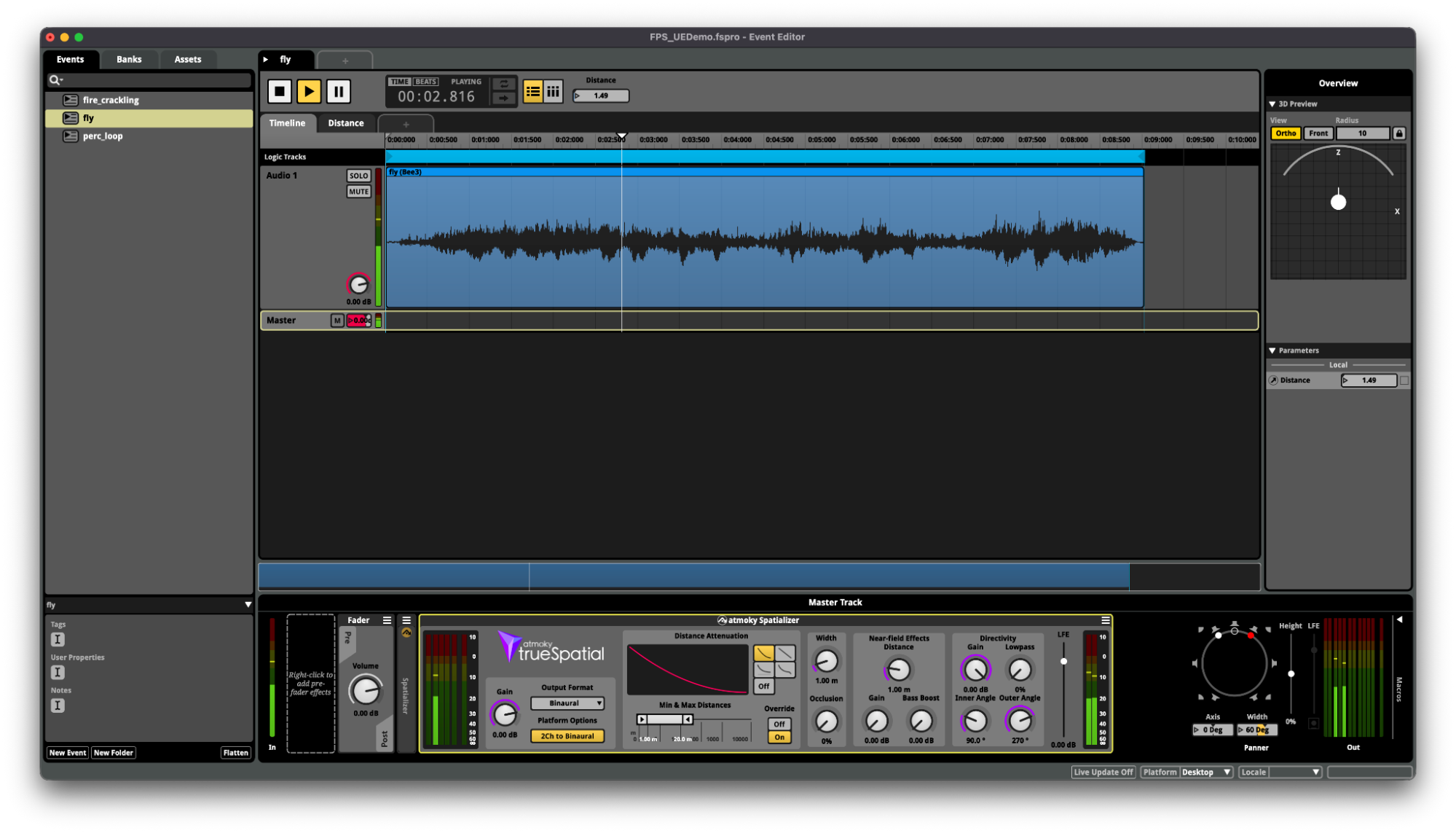

Swapping in the Spatializer
On any 3D Event in FMOD Studio, you replace the default FMOD Spatializer with the atmoky Spatializer (via Add Effect > Plugin Effects > atmoky).
atmoky Spatializer plugin in the FMOD Studio signal chain
The first thing you'll notice is the output format dropdown. The Spatializer can render to binaural (for headphones), stereo, or any channel-based surround format. There's also a "Platform" option, which reads the output format from a runtime setting, so you can let the player choose between headphones and speakers without needing separate event configurations. More on that in the signal flow section below.

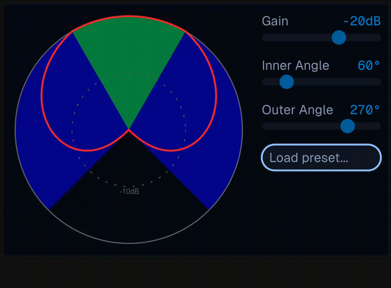

Source Directivity: Shaping How Sound Radiates
In the real world, sound sources don't radiate equally in all directions. A person speaking projects sound mostly forward, and the further you move behind them, the more muffled and attenuated it becomes.
The atmoky Spatializer includes a Directivity section that lets you recreate this behavior. There are four parameters:
Inner Angle defines the cone in front of the emitter where sound is at full level. Outer Angle defines the wider cone beyond which the sound is attenuated. Gain controls how much the sound is reduced outside the outer angle (from 0 dB down to -80 dB). Low-Pass applies a filter to sounds outside the outer angle, simulating the way high frequencies are naturally absorbed when a source isn't facing you.
atmoky Spatializer Directivity section with Inner/Outer Angle controls
The combination of gain reduction and low-pass filtering is what makes directivity feel natural rather than abrupt. A hard volume cut when you step behind a source sounds artificial. But reducing the level slightly while also rolling off the highs mimics how real acoustic sources behave: you can still hear a speaker from behind, but the sound is duller and quieter.
The documentation includes several directivity presets that can serve as starting points: Omni (no directivity at all), Cardioid, Voice, Loudspeaker, Narrow Beam, and Wide Beam. These give you a sense of how the inner/outer angle and gain/low-pass parameters interact for different source types.
This comes up in all sorts of gameplay contexts. Busy combat sequences where you need to tell apart approaching sounds from retreating ones. Stealth games where the player eavesdrops on a conversation and needs to hear the difference between facing a speaker and standing behind them.
In the video, Sergio demonstrates this with a wolf: he sets the inner angle to about 100° and the outer angle to around 200°, then walks around the source to hear the presence and clarity change. Adding a low-pass filter at 30% and reducing the directivity gain makes the difference even more pronounced.

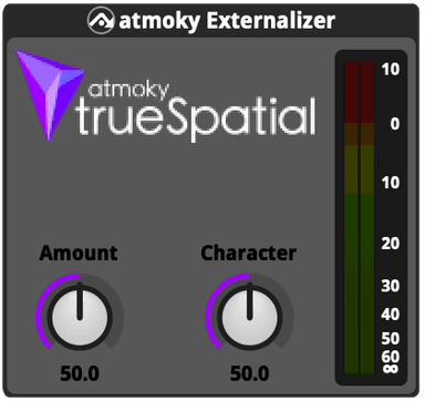

The Externalizer: Getting Sound Out of Your Head
If you've worked with binaural audio over headphones, you've probably experienced the "inside the head" problem. The sound is directional, but it feels like it's happening between your ears rather than in the space around you.
This is a well-known limitation of headphone playback. In real life, we hear sounds in rooms. Reflections, even subtle ones, give our brain cues about the distance and position of sound sources in space. Headphones remove all of that. The direct signal arrives at our ears without any room interaction, so the brain has nothing to anchor the sound to an external position. The result: everything localizes inside the head.
Externalizer GUI
Externalizer GUI
The atmoky Externalizer plugin is designed for exactly this. It adds a subtle sense of space to the binaural signal so that sources are perceived outside the listener's head rather than between the ears.
It has two controls: Amount (0 to 100, how much externalization to apply) and Character (which shapes the tonal quality of the effect, from warmer to more airy). At 0, the Externalizer is fully bypassed.

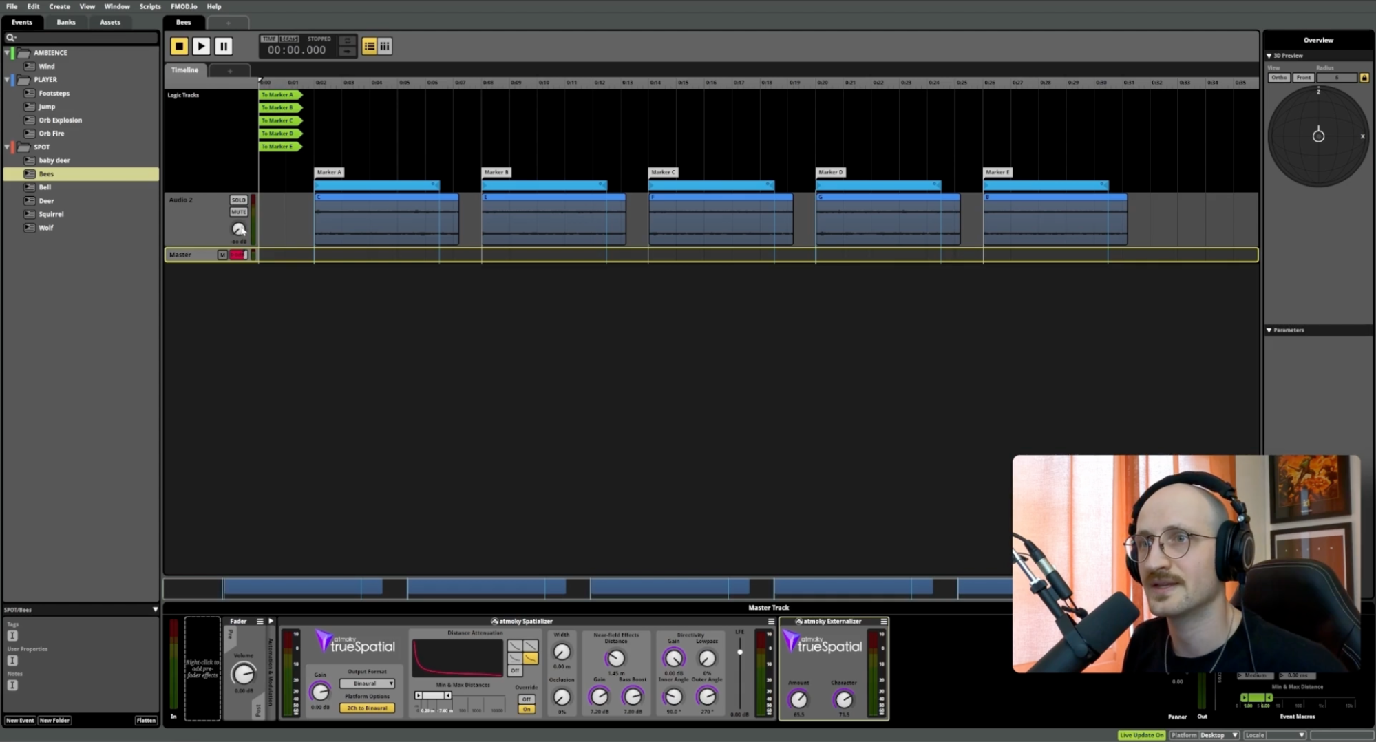

In the video, Sergio adds the Externalizer alongside the Spatializer on the firefly events, and the difference in perceived "presence" is noticeable. The sounds move from sitting inside the headphones to sitting in the scene.
Sergio Externalizer Setup

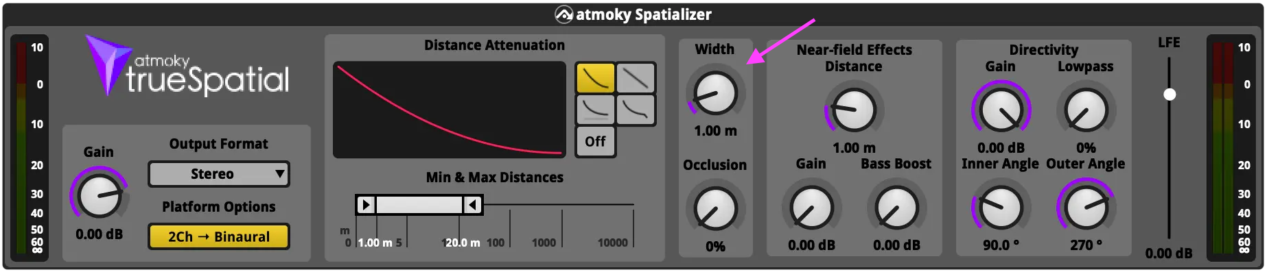

A multi-channel source as a virtual speaker rig: Spatializer with Width
This is where it gets interesting. Say you have a 5.1 music stem or a surround ambience loop, and you want to place it as an object in the game world. Think of a jukebox playing a 5.1 mix, or an in-game cinema screen with surround sound, or an outdoor concert stage.
The Spatializer handles this too. When you feed it a multi-channel input, the Width parameter controls how the channels are arranged around the source position. Each channel gets placed on a virtual sphere as if it were a loudspeaker in a physical setup. From far away, the whole thing collapses to a single point source: you hear the jukebox as one object in the distance. As the listener approaches and enters the virtual speaker rig, the individual channels start to separate and you perceive the original surround panning. It's a smooth transition controlled by the Width value and the listener's distance.
For stereo input specifically, the left and right channels are placed at ±90° (rather than the standard ±30° of a stereo speaker pair), which gives a wider spread and avoids the narrow image you'd get from placing two virtual speakers 30° apart at a distance.

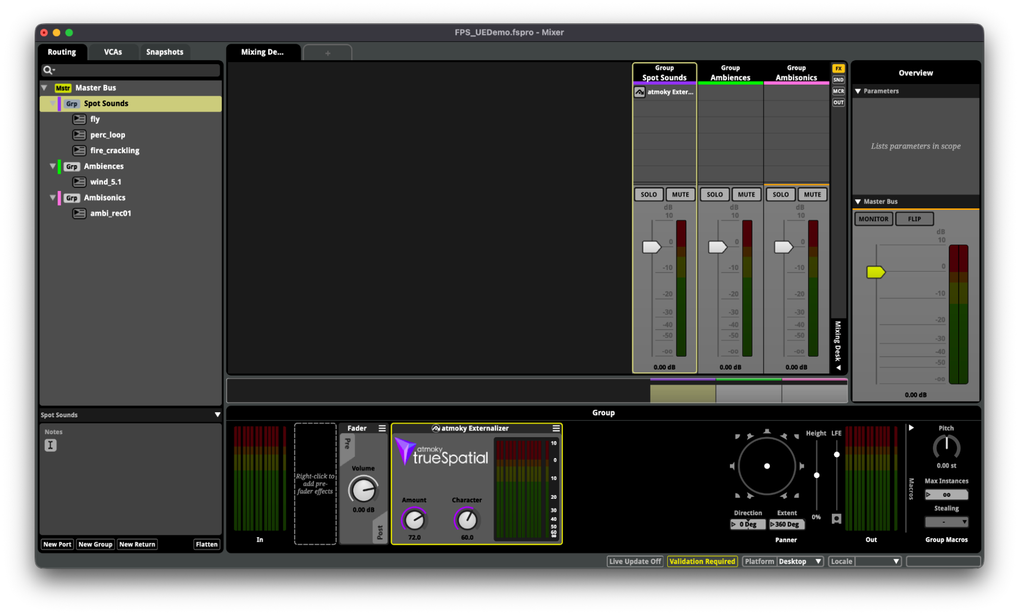

Externalizer: one instance on a group bus
The Externalizer is not a rendering plugin. It's a post-processing effect that gives you this “out-of-head” feel on headphones. It  either goes on a Single Event or on a Group Bus. Route all your spatialized binaural  events (from any of the rendering plugins above) into a shared bus, put one Externalizer on it, and you get consistent externalization across your entire spatial mix with a single point of control.
Signal flow showing three parallel rendering paths
 (Spatializer, AmbisonicRenderer, Renderer) converging at buses, with Externalizer on the Spatializer group bus
Signal flow showing three parallel rendering paths (Spatializer, AmbisonicRenderer, Renderer) converging at buses, with Externalizer on the Spatializer group bus
