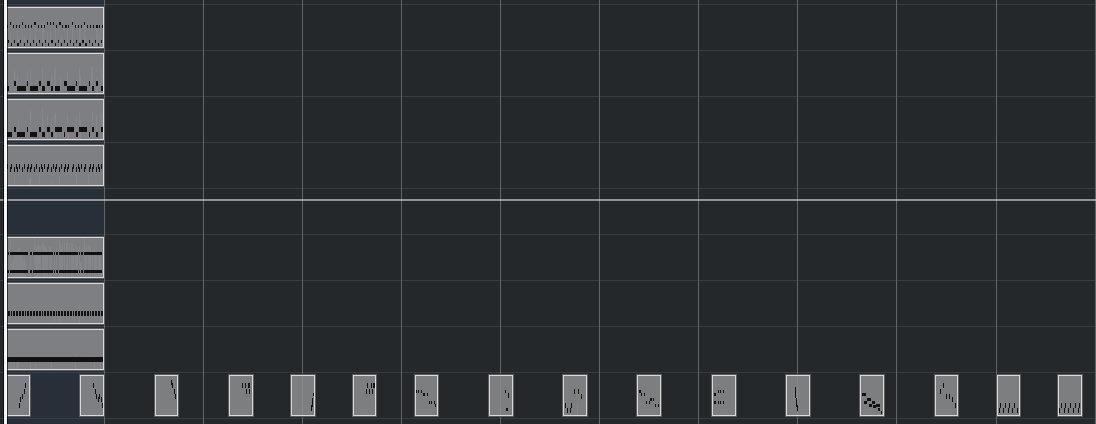

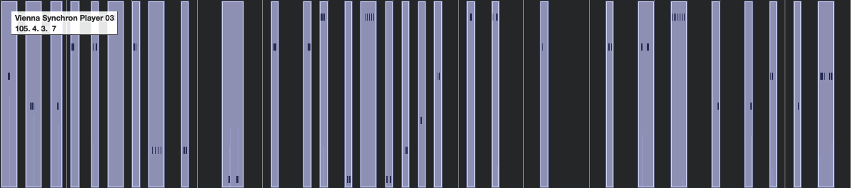

I start by creating a simple musical loop. Then, I create very simple percussive elements with random durations and no recognisable rhythmic pattern.
Percussive elements are cut before being exported

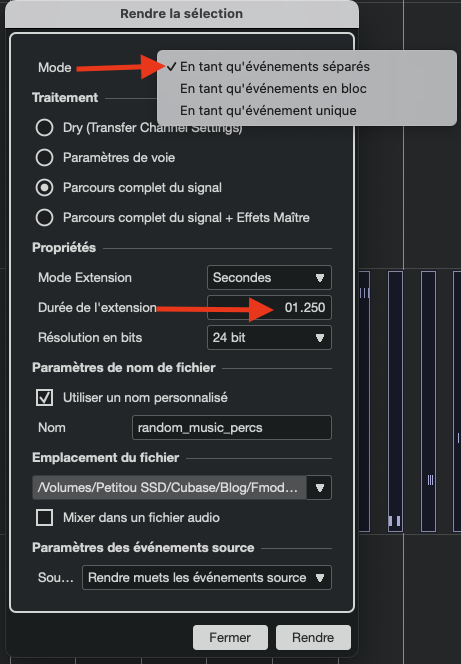

I export everything from Cubase by adding an extension time to account for the reverb tails (it's much more demanding than Reaper's export system). Here's how I proceed:
Making selection saves export time

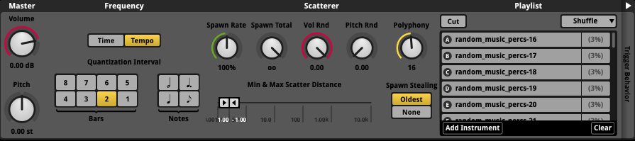

I then create a 2D Timeline Event in FMOD, I enter the tempo and looping data in the Logic Track, I import the musical loop and create a Scatterer Instrument in which I import each small piece of percussion.
Le scatterer Instrument pour la percussion

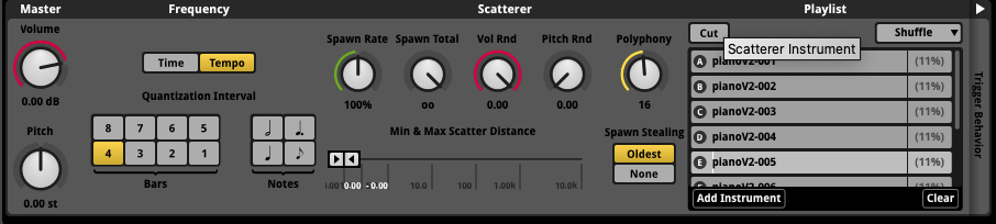

After entering the tempo in the Logic Track and setting the loop areas, I set the occurrence rate to two bars. To create variation in spatialisation, I configure the Min & Max Distance to 1.00-1.00: the sound is therefore played randomly around the listener with occlusion at approximately one metre away.
  • My settings:
    • Spawn Rate : In tempo mode, this affects the maximum number of simultaneous events triggered according to the quantisation parameters.
    • Spawn Total : We do not use this parameter here.
    • Volume Rnd : We could use it, but it is not essential in this case.
    • Polyphony : I do not touch this setting, as by fixing the parameter at 2 bars, there is no chance that more than two events will overlap.

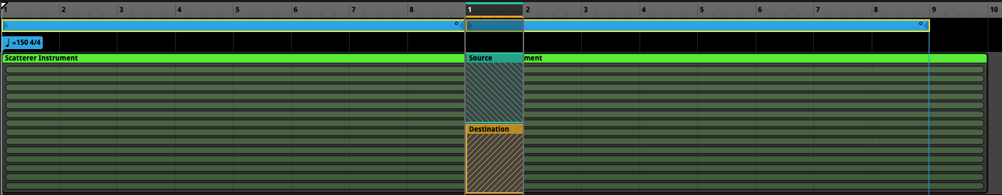

Quickly, I find myself faced with a first problem: the operation of the Scatterer Instrument within the Loop Region is somewhat enigmatic. As I am using this Loop Region for my music loop (to ensure a smooth transition), I cannot do without it. I therefore find a setting that seems suitable.
The Loop Region of FMOD is always a bit problematic

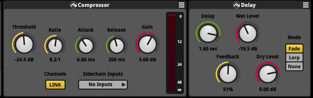

Second problem: given the absence of a trigger modifier, if I set the duration to four bars (which is the exact duration of each audio segment), there is no difference from using a Multi-Instrument that would be placed every 4 bars. I then attempt an asymmetric layering approach by setting the "pop" every 3 bars: thus, each phrase overlaps a little with the previous one to create a greater sense of unpredictability.
However, this shifts the timing of the phrases, which are initially intended to start on the first beat. In the end, some phrases sound a bit awkward, while others fare better. This is an element to anticipate if you plan to use this technique in production. Finally, I add compression and a delay to contain the sound and prevent the ends of phrases from sounding too abrupt.

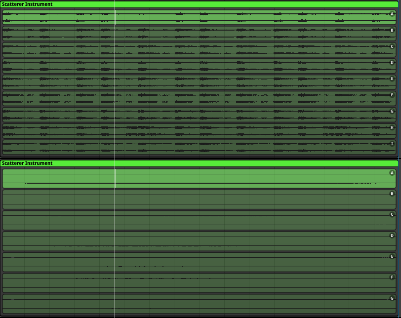

Here are the two Scatterer Instruments: at the top the piano that plays the chords, and at the bottom the synth that plays the melody:
The two Scatterer Instruments
The piano is configured so that it never overlaps. Each phrase lasts 4 bars and the appearance rate is set to 4 bars. In this strict configuration, there is again no difference from a simple Multi-Instrument.
The Scatterer Instrument works like a multi-instrument
To add unpredictability to the melody, the phrases last about 4 bars, but I set the occurrence rate to 3 bars. As in the example above, this allows for overlapping phrases. Since these are single notes, the layering works quite well.

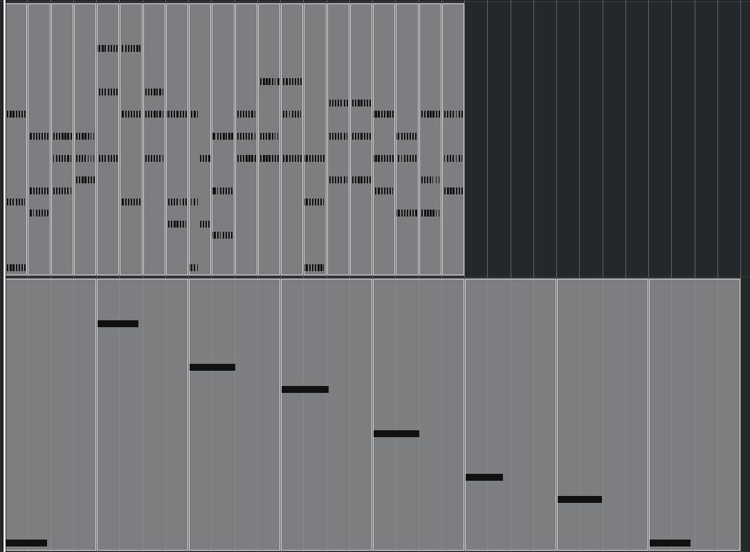

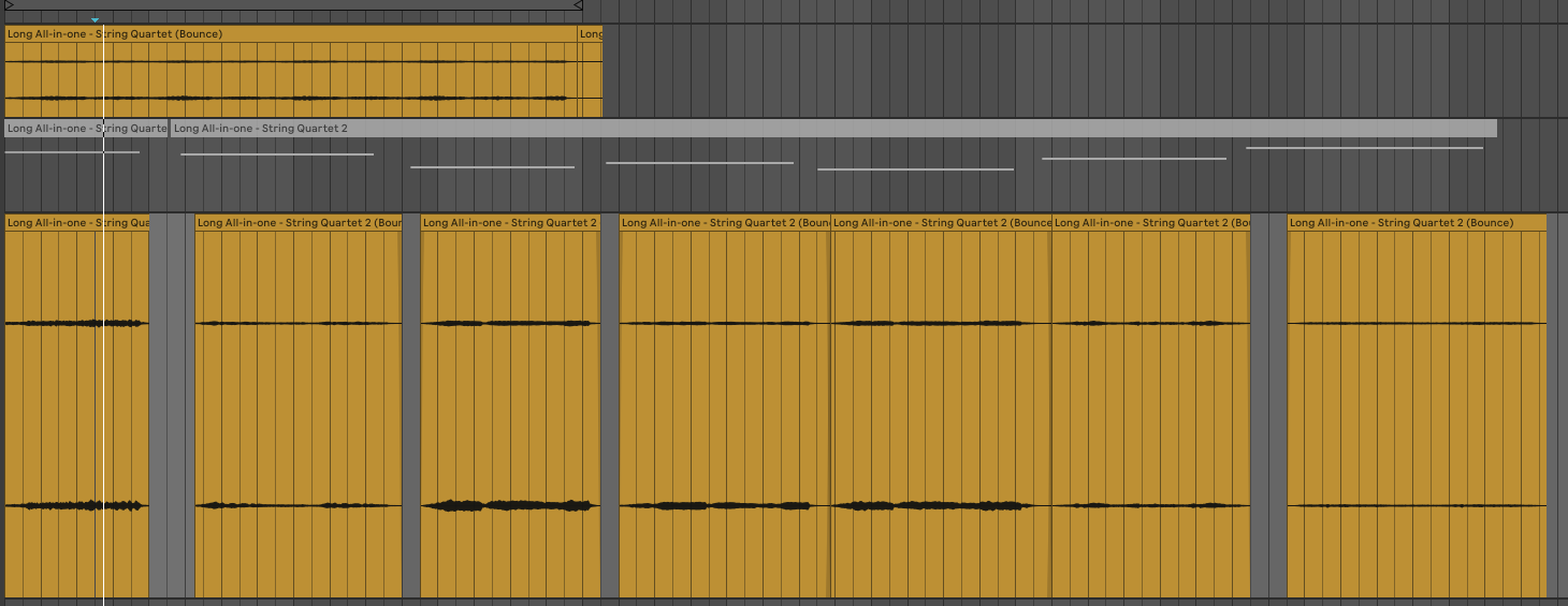

Ultimately, to fully take advantage of the random spawn feature of the Scatterer Instrument, I need to let go of the Tempo approach. Therefore, I am trying a rubato approach with a non-rhythmic drone that loops. On top of that, I place "non-metric" notes, exported and integrated into FMOD.
In the Ableton Live session (the drone at the top, the different notes at the bottom), it is clear that each note has a random duration.
The Ableton session before the export

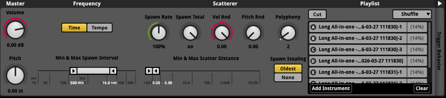

I create a Scatterer Instrument and insert each of the notes exported from Ableton Live. Since we have neither tempo nor imposed rhythm here, we can finally define a true random range for triggering (Spawn Rate).
  • I keep the event in 2D.
  • I set the polyphony option to 2 so that the notes can overlap.
  • I add reverb to lengthen the notes and facilitate transitions.
Set to Time, the Scatterer Instrument returns to normal functioning
