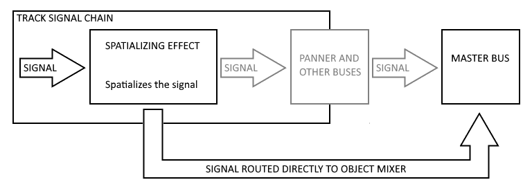

15.2.2 The FMOD Object Spatializer Effect
The object spatializer effect is specifically designed to work with platform-specific technologies such as Windows Sonic, PlayStation VR, and Dolby Atmos. It functions by routing the signal and the event's 3D positional information directly to an object mixer, instead of through the tracks and buses into which the event is nominally routed. As a result, the signal does not encounter any effects or sends "downstream" of the object spatializer. Unlike the FMOD spatializer effect, the object spatializer does not automatically upmix the signal to your project's surround speaker mode.
Object Spatializer Effect Diagram
Because it is designed to take full advantage of platform-specific technologies, the object spatializer can potentially spatialize audio more accurately than the spatializer effect. However, as most platforms only support a limited number of object spatializers, it is best to use the object spatilizer effect only in events that need highly accurate positioning, and to use the spatializer effect in all other events.
When running on a platform that does not feature any specific spatialization technologies, an FMOD object spatializer effect instead functions as an FMOD spatializer effect, but still routes its signal directly to the mixer instead of through the normal routing path the event would otherwise follow.

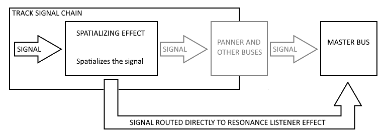

15.2.3 The Resonance Audio Source Effect
The Resonance Audio source effect is a third-party plug-in that functions in a manner similar to the FMOD object spatializer effect: It functions by routing the signal and the event's 3D positional information directly to a Resonance listener effect in your project's mixer instead of through the normal routing path the event would otherwise follow. As a result, the signal does not encounter any effects or sends "downstream" of the Resonance Audio source. Unlike the FMOD spatializer effect, the Resonance Audio source does not automatically upmix the signal to your project's surround speaker mode.
A Resonance Audio source effect requires there to be at least one Resonance Audio listener effect in your project's mixer. This effect is usually placed in the signal chain of the project's master bus, or in the signal chain of a group bus that routes into the master bus. Having more than one Resonance Audio listener effect in a project is not recommended, as it can result in choppy or distorted playback.

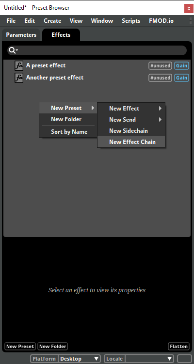

You can add an effect chain to your project by right-clicking on the effects browser and selecting "New Preset > New Effect Chain" from the context menu. In addition, you can convert an existing preset effect into an effect chain containing that effect by right-clicking on the preset effect in the effects browser and selecting "Wrap in Effect Chain" from the context menu. You can also create a new effect chain by selecting a track in the event editor window, right-clicking on the deck, and selecting "Add Effect Chain" from the context menu.
New Effect Chain Context Menu Command

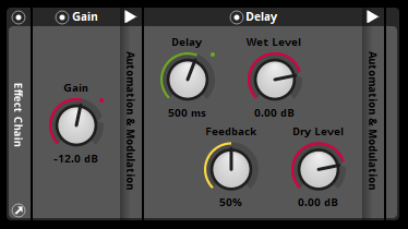

All instances of an effect chain have the same effects, sends, and sidechains, with the same property settings, including any automation and modulators. Because the properties of effects and sends in an effect chain can be subject to automation and modulation, it is possible for different instances of an effect chain to have different current property values. If an effect chain makes use of game parameters (for example, for automation), those parameters are automatically added to every event that contains an instance of that effect chain.
You can add effects, sends, and sidechains to an effect chain by right-clicking on the effect chain in the deck and selecting "Insert Effect," "Insert Send," or "Insert Sidechain" from the context menu. In addition, if viewing the deck of a track that contains an effect chain in the event editor window, you can click and drag effects, sends, and sidechains from elsewhere in the signal chain onto an effect chain to add them to that effect chain. Preset effects, sends to return tracks in events, and other effect chains cannot be added to effect chains.
Effect Chain With Contents
You can remove effects, sends, and sidechains from an effect chain by right-clicking on them and selecting "Delete" from the context menu. In addition, if viewing the deck of a track that contains an effect chain in the event editor window, you can click and drag an effect, send, or sidechain from inside the effect chain to a position elsewhere in the deck to remove it from that effect chain. Alternatively, if there is only one effect in an effect chain, you can remove the effect chain from the preset effect by right-clicking on the preset effect in the effects browser and selecting "Unwrap Effect Chain" from the context menu.
You can change the order of effects, sends, and sidechains in an effect chain by clicking and dragging them to new positions.
Editing any effect chain anywhere in your project affects every instance of that effect chain throughout your project. If you want to make changes to the contents of an effect chain without affecting other instances of that effect chain elsewhere in your project, right-click on the effect chain and select "Detach from preset." This replaces that instance of the effect chain with a series of effects, sends, and sidechains identical to the effects, sends, and sidechains in that effect chain, but which are not linked to the preset effect.

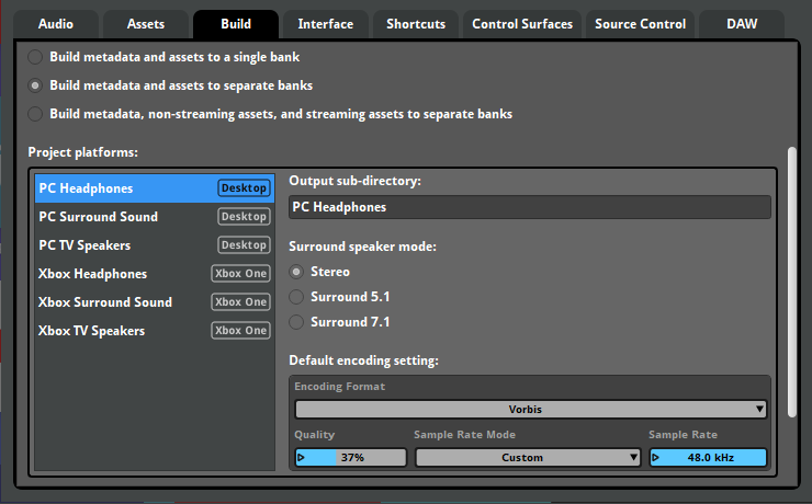

The build platform list in the preferences dialog can have multiples of the same platform. Each duplicate of a platform can represent a different hardware configuration for that platform. For example, in the build tab of the preferences dialog, you can have this setup:
  • PC Headphones (Desktop) - Stereo surround speaker mode
  • PC Surround Sound (Desktop) - Surround 7.1 surround speaker mode
  • PC TV Speakers (Desktop) - Stereo surround speaker mode
  • Xbox Headphones (Xbox One) - Stereo surround speaker mode
  • Xbox Surround Sound (Xbox One) - Surround 7.1 surround speaker mode
  • Xbox TV Speakers (Xbox One) - Stereo surround speaker mode
Example project platforms list

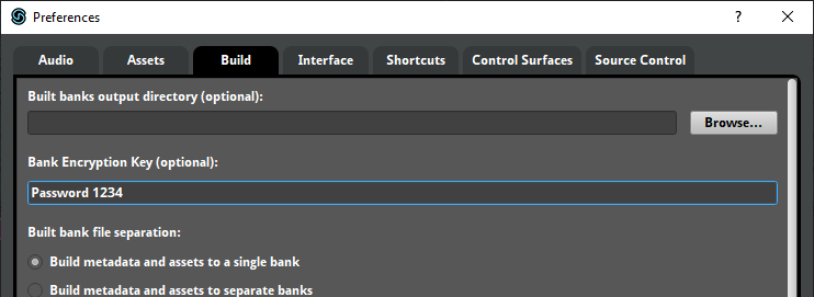

15.14 Bank Encryption
Built banks are not designed to be "decompressed" or "decompiled," and do not include sufficient data to reverse the build process and recreate the FMOD Studio project from which the bank was built. Still, someone with sufficient programming knowledge and familiarity with the FMOD API could theoretically create a program that reads sample data from your game's bank files. Such a program could be used to obtain audio spoilers for your game, or to create illegal copies of your game's copyrighted audio content.
You can prevent this by setting a bank encryption key for your FMOD Studio project in the build tab of the preferences dialog. A bank encryption key may contain any number, type, and combination of characters, including spaces and symbols as well as alphanumeric characters.
The Bank Encryption Key
If your project has a bank encryption key, its bank files are encrypted using that key when you build the project. An encrypted bank file can only be loaded by a game project whose FMOD_STUDIO_ADVANCEDSETTINGS struct includes the correct encryption key as its encryptionkey member. For example, if you set your FMOD Studio project's bank encryption key to "Password 1234", your banks could only be loaded by a game whose FMOD_STUDIO_ADVANCEDSETTINGS struct's encryptionkey member was also "Password 1234".
Note that bank encryption is a deterrent that increases the difficulty of reading data from your banks. It can not stop players from playing your game and recording the audio.
