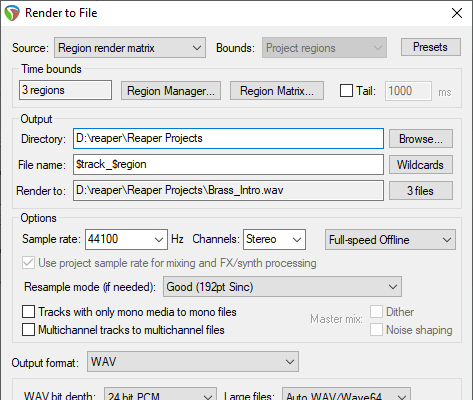

To export the project timeline correctly, each track and region within the project must have a valid name. Additionally, the project's render options must be configured as follows:
  • Source: "Region render matrix"
  • File name: "$track_$region"
  • Directory: Must match the "Rendered Assets Path" field of the linked project asset. It is best to set this to a path that differs from the media files location of the Reaper project, so that media files used in the Reaper project are not imported as linked audio assets.
  • Output format: Must be set to "WAV".
Render to File dialog in Reaper

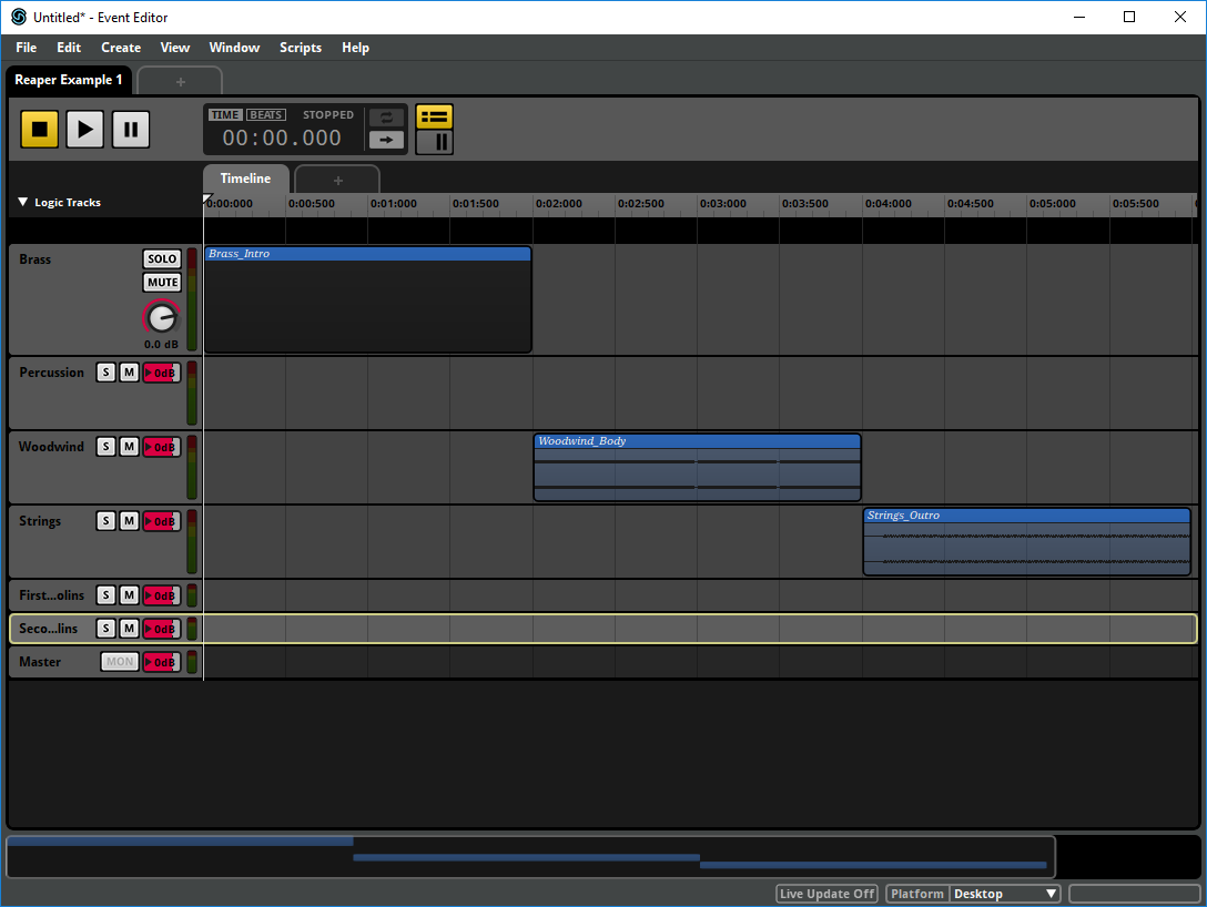

Example of Reaper Project Separate Tracks Rendering
In the example pictured above, six tracks will be exported and the name of the tracks are "Brass", "Percussion", "Woodwind", "Strings", "First Violins", and "Second Violins" respectively. Based on the region render matrix, three single instruments will be exported and placed on the tracks. For example, this would export a single instrument starting at 00:00.000 with a length of 00:02.000 on the "Brass" track, using the rendered audio file "Brass_Intro.wav".
Example of Imported Reaper Project With Separate Tracks Rendering
The picture above illustrates the imported event based on the first Reaper project example, where the region render matrix was set to render with entries for each track.

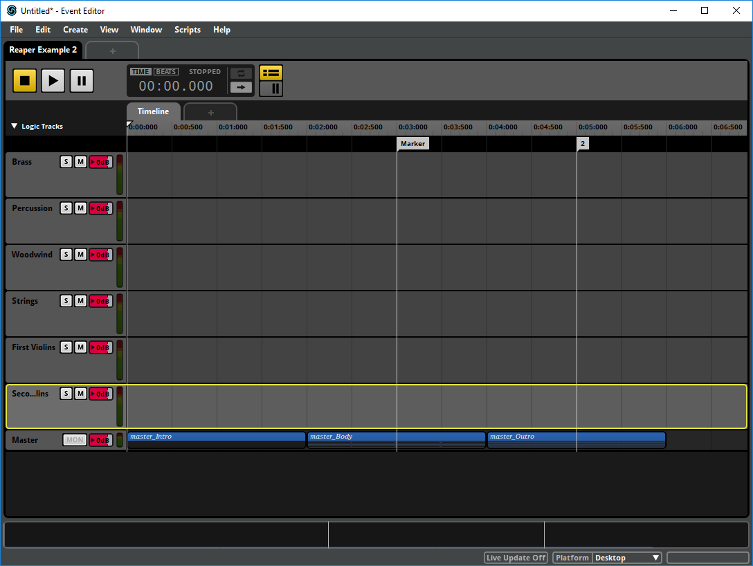

Example of Reaper Project Master Mix Only Rendering
In the example pictured above, similar to the previous example, six tracks will be exported. By setting the region render matrix to export the master mix only, three single instruments will be exported and placed on the master track of an event. The marker at 00:03.000 would be exported with the name "Marker" and the unnamed marker at 00:05.000 will be exported with the name "2".
Example of Imported Reaper Project With Master Mix Only Rendering
The picture above illustrates the imported event based on the second Reaper project example, where the render matrix was set to render for the master mix only. Also included are the two destination markers with the name "Marker" and "2" respectively.
