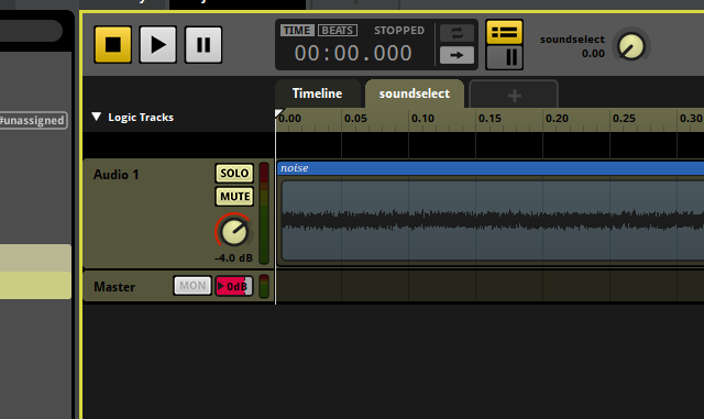

4.2.1 Soloing and Muting Tracks
The solo and mute buttons located on the head of each audio and return track, and the monitor button located on the head of the master track, allow you to control which tracks are included in an audition.
Track mute and solo buttons
The mute toggle button, if toggled on, excludes the associated track from outputting any audio.
The solo toggle button, if toggled on, excludes all audio and return tracks that don't have their solo button toggled on from auditioning. You can toggle the solo buttons of multiple tracks by holding down the Shift key as you click on their solo buttons.
The monitor toggle button is only available if any of the solo or mute buttons have been toggled on. Clicking on it when it is toggled on toggles off all toggled on mute and solo buttons in the event. Clicking on the monitor button when no mute or solo buttons are toggled on toggles on the mute and solo buttons that were toggled off when the monitor button was last clicked.

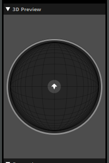

4.2.2 The 3D Preview
When viewing a 3D event, the 3D preview appears in the overview pane. The 3D preview is a tool for auditioning the 3D properties of an event. By interacting with the emitter, you can change the position of the emitter relative to the listener for the purposes of auditioning.
3D Preview
The 3D preview represents a top-down view of a spherical area surrounding the listener. The radius of this circle is equal to the event's max distance, as defined by either the max distance property of the event's spatializer effect or by the maximum value of its built-in distance parameter. The listener is always located at the exact center of the circle, facing forward ('up' on the 3D preview).
The arrow-shaped icon represents the event emitter, and the direction that the arrow points represents the direction the emitter is facing. By default, the emitter is positioned in the same location as the listener and facing the same direction. You can change the position of the emitter by clicking and dragging it to any new location in the circle, and you can rotate the emitter by hovering the mouse cursor over the 3D preview and spinning the mouse wheel. Holding down the Ctrl key while dragging the listener changes the emitter's elevation. (If the current elevation of the emitter is above or below that of the listener, the difference in elevation is indicated by a dashed line.) Double-clicking on the 3D Preview returns the emitter to its default position and facing.
3D Preview with the emitter moved
The light-gray circle surrounding the arrow represents the event's envelopment, as defined by the sound size property of the event's spatializer effect. The light gray arc or circle that appears around the edge of the 3D preview represents the current extent of the event. If a spatializer's minimum extent has been set to a value greater than 0 degrees, the minimum extent is shown as a white arc overlapping the light gray arc that represents current extent.

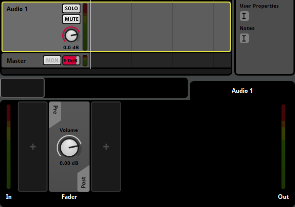

4.4.1 Audio Tracks
Audio tracks act like group buses in a mixer. They receive inputs from a variety of sources, create a submix, alter that submix with effects, and output the result to another track. The inputs of an audio track come from the instruments on that track and from any other tracks that are routed into it.
Audio track and deck
An event may contain any number of audio tracks, or none. Audio tracks may be added or removed by right-clicking on a track head and selecting "Add Audio Track" or "Delete" from the context menu.

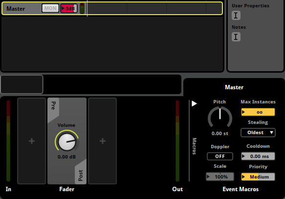

4.4.3 Master Track
The master track is a special kind of audio track that cannot be routed into other tracks. Instead, its output is always routed to the project mixer.
An event always contains exactly one master track. Master tracks cannot be deleted, and additional master tracks cannot be added to an existing event.
In all other ways, the master track behaves exactly like an audio track. Its inputs come from the instruments on that track and from any other tracks that are routed into it.
Master track and deck

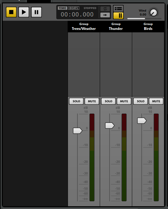

4.5 Routing
Within an event, signals originate from instruments. The output of each instrument is routed into the track that instrument is on. These tracks, in turn, produce outputs that may be routed into other audio tracks, the master track, or to the mixer.
The signals routed into each audio, return and master track are used to produce a submix, which in turn forms the output of the track. The master track's output always routes into the project mixer.
By tweaking and customizing an event's routing, you can change which tracks' signal chains each track's output is processed by. This allows you to create events where different content is processed in different ways. For more information about signal chains, see the signal chains section of this chapter.
By default, the output of audio tracks and return tracks is routed into the event's master track. You can set any return or audio track to route into a different audio track by right-clicking on its track head and selecting the "Output" menu item from the context menu.
Unlike audio tracks, return tracks do not receive input from instruments on the track. Instead, you can create sends to those return tracks in any track's signal chain. Sends create a duplicate of the signal at their position, and this duplicate signal is routed to a specified return track in the same event or to a return bus in the project mixer. For more information about the project mixer, see the Mixing chapter.
The master track's output (also known as the event output) may be routed into any group bus or master bus in the project mixer. By default, every event is routed into the project master bus. The routing of an event can be changed in the routing browser. For more information about routing in the mixer, see the Mixing chapter.

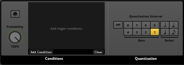

Probability condition
To give the selected marker a probability condition, first click on the probability toggle button where it appears in the deck to turn the marker's probability mode on, then click and drag the chance number box to the desired value.
You can also create parameter conditions for markers. A marker with parameter conditions functions only while the values of the event's parameters are within certain ranges. Parameter conditions on loop regions only affect the loop region, and not transition markers and regions linked to that loop region.
To add a parameter condition to the selected marker, click on the "Add Condition" button in the deck, then select a parameter from the menu. You can change the range of values used by an existing parameter condition by double-clicking on one of the values and entering a new one, or by clicking and dragging the handles of the ribbon slider.
Transition regions and magnet regions, unlike transition markers and loop regions, can be quantized. Quantizing a transition region or magnet region means that it will only cause the playback position to jump on the specific notes or bars to which that region is quantized. The timeline positions of beats and bars in an event are determined by the event's tempo markers. If there are no tempo markers in the event, it defaults to 120 beats per minute and 4/4 time for this purpose.
Quantization
When a quantized transition region or magnet region has a probability trigger condition, the probability condition is checked once each time the playback position reaches a quantization point.
To apply quantization to a transition region or magnet region, select that region then click on the desired quantization interval button in the deck.
