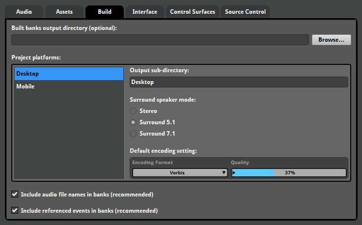

You may opt to prevent referenced events from being automatically assigned to their parent events' banks. To enable this option, open the preferences dialog dialog and uncheck the "Include referenced events in banks" option in the build tab.
Include referenced events in banks option
Enabling this option means you have to manually assign each referenced event to a bank in order to use it in game. By assigning and building a commonly used referenced event to a specific bank, the referenced event and its sample data is only built into that bank and can be used by all events referencing it. This assists with reducing the file size of built banks.

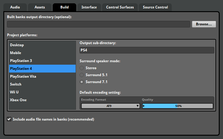

To add platforms to your builds list, right click into the "Project Platforms" list in the preferences dialog's build tab and choose the appropriate platform from the "Add Platform" list.
Platform Encoding Settings
You can add the same platform to the project platforms list multiple times to represent multiple hardware types. For example, you can have two Desktop platforms, naming one as "Windows" and one as "Mac", if needed.
You can specify how your assets are compressed and encoded when built into your banks. This affects file sizes, load times, and performance. Compression formats are set on a per platform basis and can be overridden on a per asset basis.
You can set the default encoding setting for a platform in the preferences dialog. Under the build tab, select the desired platform in the project platforms list, then select a default encoding setting. Some platforms support special encoding formats, such as AT9 and XMA. All encoding settings other than PCM involve compression.

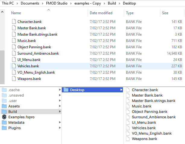

In the above screenshot, you can see each bank from the FMOD Studio example project is built into a .bank file, along with Master.bank and a Master.strings.bank file.
Bank files are what your game uses to produce audio. Once built, they no longer require FMOD Studio to function, and are ready to be added to your game.

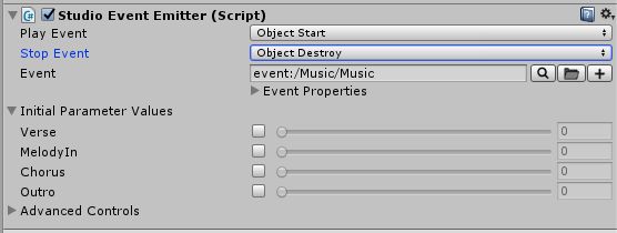

The first way is to add an FMOD Event Emitter component to a game object, choosing the event to play, and when to play it.
Unity Event Emitter

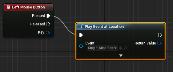

The second way is to use the "Play Event at Location" function in Blueprints to trigger any given event.
For more information on both of these methods, see the UE4 Integration documentation.
