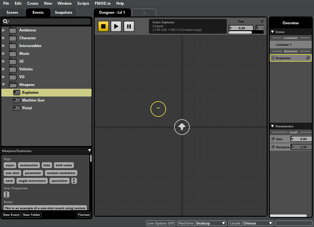

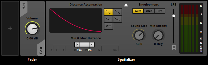

A 3D event is an event whose position in three-dimensional space affects its behavior. To be 3D, an event must feature at least one built-in parameter or effect with spatial behavior.
The most common way of making an event 3D is to add an FMOD spatializer effect to one of its tracks. This effect pans and attenuates the signal as if it came from a particular direction and distance relative to the listener. Other effects with spatial behavior, such as the FMOD object spatializer and the Resonance Audio source, also make an event 3D.
Built-in parameters only audibly alter an event's behavior if they are used to trigger instruments in that event, to automate properties of that event, or to automate the properties of that event's instruments.
When viewing a 3D event in the event editor window, the 3D preview appears in the overview pane.
25.2 3D Preview
The 3D Preview is a tool for auditioning any behavior of an event that depends on the event's position relative to the listener in three-dimensional space. The 3D Preview appears in the overview pane when a 3D event is displayed in the editor.
The 3D preview represents a top-down view of a spherical area surrounding the listener. The radius of this circle is equal to the event's max distance, as defined by either the max distance property of the event's spatializer effect, or by the maximum value of its distance parameter. The listener is always located at the exact center of the circle, facing forward ('up' on the 3D preview).
The arrow-shaped icon represents the event emitter, and the direction that the arrow points represents the direction the emitter is facing. By default, the emitter is positioned in the same location as the listener and facing the same direction. You can change the position of the emitter by clicking and dragging it to any new location in the circle, and you can rotate the emitter by hovering the mouse cursor over the 3D preview and spinning the mouse wheel. Holding down the Ctrl key while dragging the listener changes the emitter's elevation. (If the current elevation of the emitter is above or below that of the listener, the difference in elevation is indicated by a dashed line.) Double-clicking on the 3D Preview returns the emitter to its default position and facing.
3D Preview
The light-gray circle surrounding the arrow represents the event's envelopment, as defined by the sound size property of the event's spatializer effect. The light gray arc or circle that appears around the edge of the 3D preview represents the current extent of the event. If a spatializer's minimum extent has been set to a value greater than 0 degrees, the minimum extent is shown as a white arc overlapping the light gray arc that represents current extent.

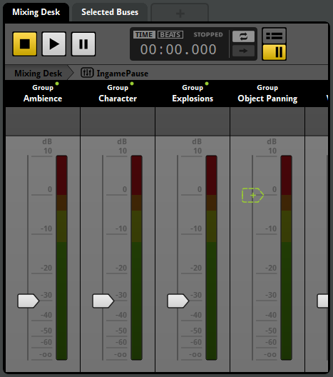

25.62 Mixing Desk
The mixing desk is found in the mixer window, and allows you to view and edit your project's mixer. In the mixing desk, buses are represented by mixer strips, and selecting one of these strips causes the signal chain of the associated bus to appear in the deck.
Mixing desk

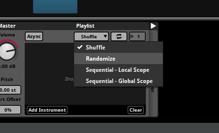

25.76 Playlist Selection Mode
A playlist selection mode is the method by which a multi instrument or scatterer instrument selects items to play from its playlist.
There are four playlist selection modes:
  • In shuffle playlist selection mode, the items in the playlist are selected for playback in random order. In addition, as long as the playlist contains at least three instruments and does not include play percentages, no instrument in that playlist will be selected twice in a row.
  • In randomize playlist selection mode, items in the playlist are selected for playback at random. The frequency and recency with which items have been selected in the past have no bearing on the probability of those items being selected in future.
  • In sequential - local scope playlist selection mode, items in the playlist are selected for playback in the order in which they are listed. Only items selected within the same event instance are taken into account, so a new instance of an event always starts by selecting the first item in the playlist.
  • In sequential - global scope playlist selection mode, items in the playlist are selected for playback in the order in which they are listed. Every instance of the event is taken into account, so a new instance of an event always selects the playlist item following the item that was selected most recently, even if that item was selected in a different instance of the event.
Playlists are set to shuffle mode by default.

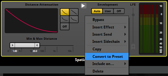

To convert an existing effect or sidechain into a preset effect, right-click on the effect or sidechain in the deck and select "Convert to Preset" from the context menu.
Convert to Preset

25.84 Project Mixer
The mixer represents and allows you to edit your project's routing and mix.
The mixer may be found in the mixer window.

Return buses can be displayed as return tracks in the mixing desk. To do this, select a snapshot whose scope includes the return bus, then set the mixing desk to tracks view.

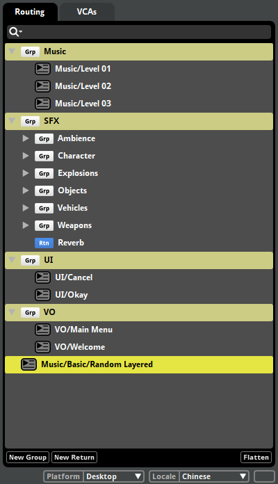

25.88 Routing
Routing is the process by which audio signals are transported from one element of a project to another. The outputs of instruments are routed into the audio tracks or master tracks on which those instruments are placed, the outputs of audio tracks are routed into other audio tracks or into the event's master track, the output of events' master tracks are routed into group buses or the project's master bus in the mixer, and the outputs of buses in the mixer are routed into other group buses or into the project's master bus.
Routing browser
In the Routing Browser, the arrangement of buses represents the routing of the project; Signals are routed from right to left, with the outputs of the leftmost buses being routed into the project's master bus.
Setting up routing is an essential part of mixing your project.

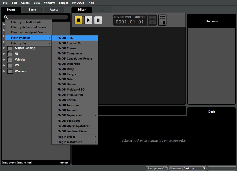

25.92 Searching
Large projects often contain hundreds, thousand or even tens of thousands of events, audio files, buses, and other items. Being able to find specific elements of a project quickly and efficiently is a critical aspect of project management and workflow.
To simplify searching for items, each browser has a search bar below its browser tabs, marked by a white loupe icon.
console
You can type in complete words, partial words, or even single letters to define a search. FMOD Studio instantly updates the items displayed in the browser that match the search terms. The items listed are relevant only to the type associated with the active browser, so searching in the event browser finds matching events, searching in the asset browser only finds matching sound files, and so on.
All search bars can be used to search for items using the following terms:
  • Snippets of text inserted
  • {%items_GUID%} - The item's GUID
  • event:/%path_to_item% - The item's path
Items can be dragged onto the browser search bar to find out the GUID and path, as well as right clicking and choosing "Copy GUID" or "Copy Path".
You can find a menu of pre-defined search terms by clicking on the loupe icon.

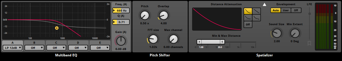

25.99 Spatializer Effect
The spatializer effect is an effect that attenuates and pans a signal based on the event emitter's position relative to the listener and the spatializer effect's properties. This "spatializes" the signal, making it sound as if it came from a particular direction and distance.
Spatializer Effect
Note that the spatializer effect upmixes signals to the platform surround speaker mode in order to apply panning and attenuation in that mode, and so may result in minor changes to the stereo or surround qualities (including panning) that the signal had prior to being spatialized if it was in a different format.
Note also that, as each instance of an event can have a different position relative to the listener, each instance may be affected differently by that event's spatializer. This is the most common method by which event instances in different game locations are made distinct.
The min & max distance properties and rolloff mode of a spatializer effect together determine how much the signal is attenuated at different distances.
The default rolloff mode is linear squared, and is suitable for the vast majority of games and events without further modification. In linear squared rolloff mode, the signal is not attenuated when the listener is within the spatializer's min distance, is -∞ dB when the listener is beyond the spatializer's max distance, and drops off according to a linear squared curve as the listener moves from the min distance to the max distance. The other available rolloff modes are linear, inverse, inverse tapered, and off.
The distance property uses the same unit of distance as your game unless your game code provides a conversion. (The FMOD UE4 integration includes such a conversion by default: It converts from Unreal units to FMOD Studio distance units at a rate of 100 Unreal units = 1 FMOD Studio distance unit.) Note that most examples and tutorials for FMOD Studio are designed for distance units one meter long, as many modern game engines use meters as their standard unit of measurement.
The pan override section of the spatializer effect is accessed by clicking on the disclosure triangle in the center of the spatializer. The pan override panner allows you to manually define panning for the signal, and the mix property allows you to blend between this manually defined panning and the automatic panning based on the event emitter's position relative to the listener. Note that the panning specified using the pan override panner does not depend on the event emitter's position relative to the listener.
Envelopment determines the extent of the event at any distance from the listener. The default, auto mode, sets min extent to 0 degrees and sets sound size to twice the spatializer's min distance property, and is usually sufficient to prevent event instances from suddenly "flipping" from one side of the listener to the other when they pass the listener at close range. User mode allows you to specify the spatializer's sound size and min extent manually, and off mode disables sound size and min extent.
Note that even if the listener is inside the diameter defined by the sound size, the event will still have some directional qualities unless the listener is at the exact same location as the emitter.
The spatializer's LFE property determines the volume of the Low Frequency Effect (LFE) channel in the spatializer's output. If the signal has no LFE content prior to being spatialized, you can click on the speaker icon below the LFE slider to enable or disable LFE upmix, which automatially generates LFE output based on the output of the other channels.
The spatializer's meters show the levels of each channel in the spatializer's output.

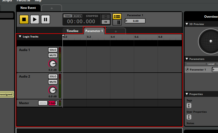

Timelines are a type of parameter with special properties.
An event can contain no more than one timeline parameter. Every newly created event contains a timeline parameter by default.
A timeline automatically increases its value over time while the event plays. The initial value of a timeline is always zero.
Timelines are the only parameters capable of triggering logic markers.
Timelines are not based on preset parameters.
