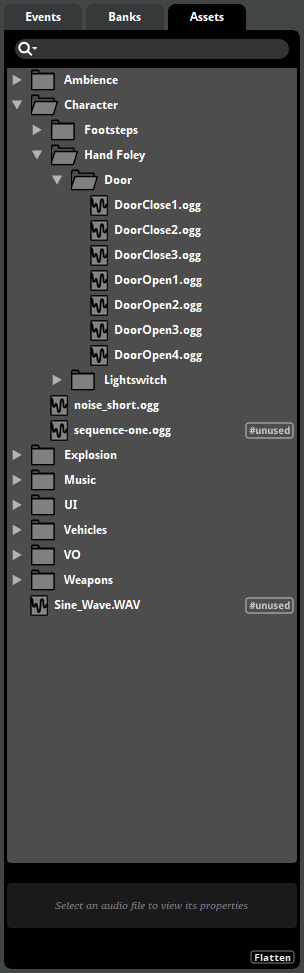

6.1 Anatomy of the Assets Browser
The assets browser displays the audio files and folders in your project's assets directory. It allows you to audition, edit, and organize your project's audio files, as well as to add those files to instruments and events. It can be found in the event editor and the audio bin windows.
assets browser
At the top of the assets browser is the assets browser search bar. Below it are all the files and folders in your project's "Assets" subdirectory. You can drag files from your file manager onto the assets browser in order to import them into your project. You can drag files from the assets browser onto instruments, tracks, playlists, and the events browser to use them in your project.
When an asset or folder is selected, its custom encoding settings and asset preview (if any) are displayed at the bottom of the assets browser.

6.2.3 Folders
Folders in the assets browser represent actual folders in your FMOD Studio project's assets folder. To create a new folder, right-click on an empty space and select "New Folder".
You can right-click on an asset or folder and select "Move Into New Folder" from the context menu to create a new folder in that location and move the selected item into that new folder.
You can move any item in the assets browser into a new folder by dragging it onto that folder.

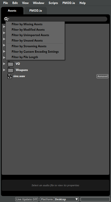

6.2.7 Searching for Assets
You are able to search through your FMOD Studio project's assets in the assets browser.
In addition to searching for assets by name, you can search for assets that fit particular categories by clicking the loupe icon and selecting an item from the menu. Each menu item automatically fills the search bar with a specific search term and filters the browser to display only files and folders that fit specific criteria, as follows:
Menu item Term Displays
Filter by Missing Assets #missing Assets that are missing.
Filter by Modified Assets #modified Assets that have been modified in an external application.
Filter by Unimported Assets #unimported Assets that are unimported (tagged as "New!" in the assets browser).
Filter by Unused Assets #unused Assets that are not used in any event. Note that assets used in audio tables are still shown if they are not also used in events.
Filter by Streaming Assets #streaming Assets that are streaming.
Filter by Custom Encoding Settings #customized Assets and folders that have custom encoding settings. Assets in folders with custom encoding settings are not shown.
Filter by File Length #query:(AudioFile.length > x) Find assets with a length longer than x (where x is a duration in seconds).
These search terms may also be manually typed into the search bar.

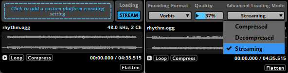

6.3.4 Loading Modes
There are several different ways in which an asset can be loaded into memory for use in your game. Each loading mode has its own advantages and disadvantages.
Assets with compressed loading mode are loaded into memory in compressed format when loaded, and then decompressed when played. This requires less memory than decompressed loading mode, but requires slightly more CPU when playing assets.
Assets with decompressed loading mode are completely decompressed into memory when loaded. This uses more memory than streaming loading mode and compressed loading mode, but requires very little CPU when playing assets. This loading mode is most commonly used for short assets that are played frequently and for mobile platforms.
Assets with streaming loading mode are continuously loaded piecemeal from disk into a small memory buffer while playing. This substantially reduces the memory required to load and play assets. However, most platforms can only support a single-digit number of simultaneously playing streams, as streaming assets require constant disk access while playing. Streaming loading mode is most commonly used for music and background ambiences.
By default, assets ten seconds or longer are automatically set to use streaming loading mode. Other assets default to compressed loading mode. You can change this behavior in the assets tab of the preferences dialog.
Automatically Stream Imported Assets Checkbox
You can change the loading mode of an asset with custom platform encoding settings by using the advanced loading mode drop-down menu.
Streaming Settings on Assets
You can change the loading mode of an asset that does not have custom platform encoding settings by clicking on the "Stream" button. This toggles between decompressed and streaming loading modes.
Because streaming assets are loaded as they play and must be buffered before they can begin playback, an instrument that plays a streaming asset may exhibit latency when triggered. It is therefore best to use non-streaming assets in instruments that require low latency.

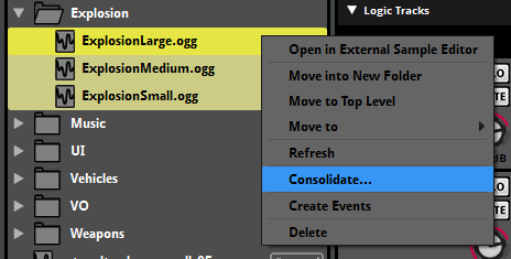

6.4 Consolidating Assets
It's occasionally necessary to replace one audio file in your project with a different audio file, or with a newer version of the same audio file. When doing this, it is not necessary to manually edit every instrument in which the old file was used. Instead, you can use the assets browser to consolidate the new and old files.
Consolidating assets is not undoable, and deletes the replaced assets from your project's assets folder on disk.
To consolidate some files, you must first multi-select the audio files to be consolidated in the assets browser. To multi-select audio files, hold down the Shift or Ctrl key when clicking on the files you want to add to the multi-selection. Make sure the selection includes both the audio file(s) you want to replace and the audio file you want to replace them with. Then, right-click on the file you want to replace the other files with, and select "Consolidate..." from the context menu.
Consolidating assets deletes all assets in the selection other than the one on which you right-clicked. It also automatically replaces all references to the deleted assets with references to the asset on which you right-clicked.
For example, in the above screenshot, right-clicking on ExplosionLarge.ogg and selecting "Consolidate..." from the context menu would cause ExplosionMedium.ogg and ExplosionSmall.ogg to be deleted from the project, and would also update all instruments that reference ExplosionMedium.ogg and ExplosionSmall.ogg to reference ExplosionLarge.ogg instead.

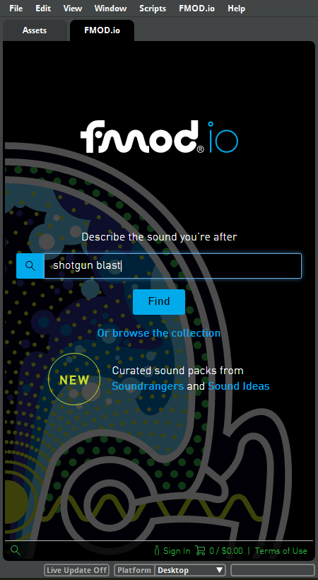

6.6 FMOD.io
FMOD.io is an online service where you can preview, purchase, and download audio files for use in your projects. All these files have been specially selected for use in games, and are brought to you by Soundrangers and Sound Ideas.
fmodIO
To access FMOD.io, either click on the FMOD.io tab in the audio bin window, or select "Jump to FMOD.io" from the "FMOD.io" menu.
You will need to sign in to an FMOD.com account in order to purchase or download audio files from FMOD.io. If you do not already have an FMOD.com account, you can sign up for one at www.FMOD.com. Creating an FMOD.com account automatically adds 50 free audio files to that account's library.
All audio files purchased through FMOD.io are yours to keep forever, and are licensed for use in any media you choose. For more information on licensing and the terms and conditions of use, please click on the "Terms of Use" button located at the bottom right of the FMOD.io window.
6.6.1 Browsing the catalog

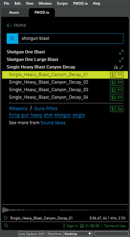

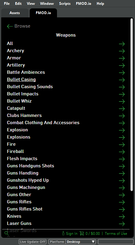

You can browse everything that FMOD.io has to offer by clicking on the "Browse the Collection" link underneath the search bar.
fmodIO
You can also search the catalog for specific audio files by typing search terms into the search bar and clicking the "Find" button.
fmodIO
Results with a right-facing green arrow are categories of audio files. You can click on any category to view the files and bundles it contains. You can go back up a category by clicking on the Back button at the top left of the FMOD.io window.
Results with a forward slash and a number next to them are bundles of multiple audio files.
You can click on any audio file or bundle of files to view its details. While viewing the details of a file or bundle, you can preview an audio file by clicking on its name.
