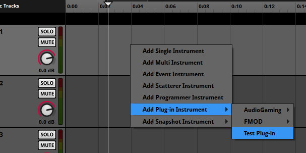

Once a DSP plug-in is loaded, it can be used within the project. Plug-ins with zero input channels, often referred to as generators, can be added as plug-in instruments.
Add Plug-in Instrument

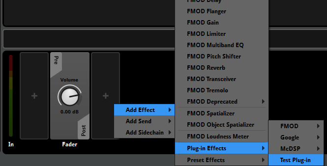

Plug-ins that process input signals can be added as plug-in effects.
Add Plug-in Effect

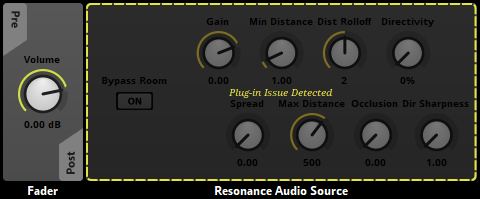

When working with custom DSP plug-ins, there may be times when migrating from an FMOD Designer project, migrating to a newer version of FMOD Studio, or the DSP's description gets updated which can cause DSPs to need repairing in the FMOD Studio project.
When an issue has been detected, the effect plug-in module or plug-in instrument is faded with a dashed yellow outline.
Effect plug-in issue detected
FMOD Studio supports repairing or removing DSP plug-in instances when a plug-in description changes or a plug-in DLL has been removed. This can be done by clicking on the deck widget of the corresponding plug-in instance. Plug-ins can be repaired or removed per instance or across an entire project.
Repairing a plug-in
