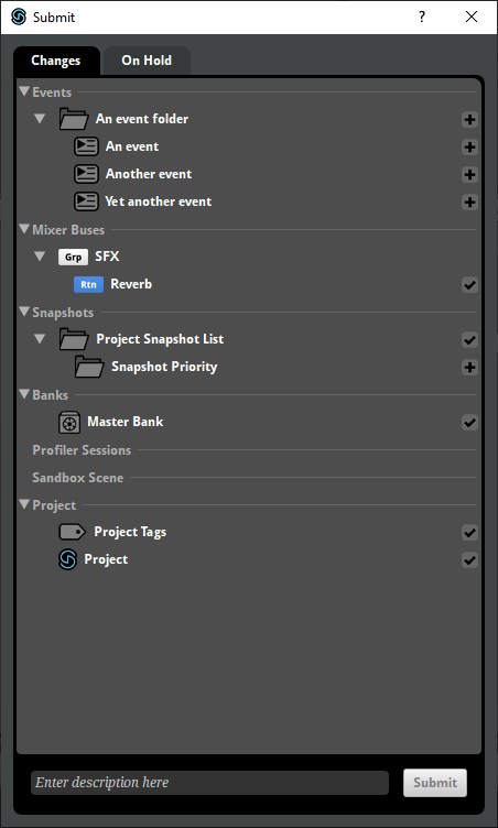

    After a few moments, the submit dialog appears. Its "Changes" tab displays a list of every element of the project to be submitted. At the bottom of the dialog is a field labeled "Enter description here" and a grayed-out button labeled "Submit."
    The Submit Dialog
    The Changes tab displays everything that's going to be submitted to the repository. In this case, that means the entire project.
    The "On Hold" tab lets you exclude specific parts of the project from being submitted. You don't need to use that tab when submitting a project to the repository the first time. For information about the On Hold tab, see the committing Changes section of this chapter.
    Whatever you type into the "Enter description here" field is used as the description of the changelist in Perforce. It's good practice to write a description that can be easily understood without additional context.

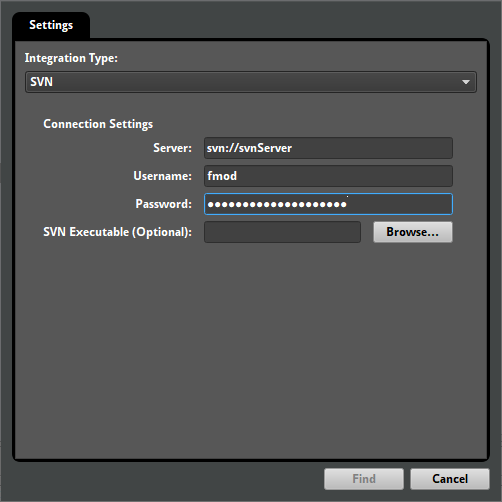

  1. Select "File > Source Control > Browse for Project"
    The open dialog appears. Select your source control solution of choice from the integration dropdown menu, which is set to Perforce by default. Fields for entering your connection settings properties appear below the dropdown menu.
    The Open Dialog - Perforce
    The Open Dialog - SVN
    The server and user fields might already be filled in. FMOD Studio automatically detects open Perforce connections, and uses the details of those connections to fill out those fields if it can. That said, FMOD Studio can't detect your Perforce password, and if you use multiple open Perforce connections it might not select the one you want.
  2. Enter the server you want to connect to and the user you want to connect as into the server and user fields.
    If you don't know the I.P. address and port of your source control server, ask your network administrator.
  3. Enter the password in the "password (optional)" field if your source control server requires a password.
    Some source control servers don't require passwords, but most do. If you don't know the password for the user you're connecting as, contact your source control system administrator.

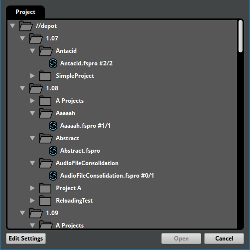

  5. Click the "Find" button at the bottom of the dialog.
    A progress dialog appears as FMOD Studio searches the source control depot. After a few moments, the dialog displays a browser populated with the projects in that depot.
    The Open Dialog
    This browser allows you to select a specific FMOD Studio project to create a local copy of and load. If the project you want a local copy of is not displayed in the browser, it may be missing from your Perforce depot, or in a part of the depot other than the part that your local workspace corresponds to.
  6. Select the FMOD Studio project you want to create a local copy of, then click the "Open" button at the bottom of the dialog.

    Once saving and preparation is complete, the submit dialog appears. It has two tabs, "Changes" and "On Hold." Under the Changes tab is a list of project elements with changes to be committed.
    The Submit Dialog
    If there's any elements of the project whose changes you don't want to commit to the repository yet, you can avoid committing them by dragging them onto the On Hold tab. Elements on the On Hold tab are not committed, but will remain marked as changed and can be committed later. If you change your mind about an element that's on hold, you can simply switch to the On Hold tab and drag it onto the Changes tab.
    The On Hold Tab
    Note that dragging certain elements of the project onto the On Hold tab or Changes tab automatically causes some related elements to move to that tab as well. This indicates that those elements are all stored in the same file on disk, and so cannot be committed or put on hold individually.
    Once you've decided which elements of the project to put on hold and which you want to commit, it's time to send the changed files to the repository.
  3. Click on the "Enter description here" field, and type an appropriate description of the changes you've made.
    Whatever you type into the "Enter description here" field is used as the description of the change in your source control repository. It's good practice to write a description that can be easily understood without additional context.

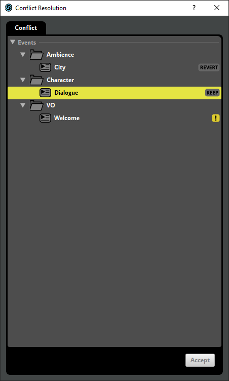

13.5.1 Resolving Conflicts
If any of the changed elements that you commit have also been changed by someone else, the conflict resolution dialog appears.
The Conflict Resolution Dialog
This dialog lists all the elements of your project that have been changed by other users since you last synchronized your project. In order to finish committing your changes, you must resolve each of the conflicts.
To resolve a conflict, right-click on the element and select "Accept Theirs", "Accept Yours", "Merge", or "Revert" from the context menu.
  • Selecting "Accept Yours" means that when you click the accept button, your changed version of the element will be committed to your source control repository, while their changes to that element will be discarded.
  • Selecting "Accept Theirs" means that when you click the accept button, their version of the changed element will remain in your source control repository, while your version will be discarded. Note that changes discarded in this manner cannot be recovered.
  • Selecting "Merge" means that when you click the accept button, FMOD Studio will apply both your changes and the other user's changes to the element, as long as those changes are compatible with each other. If any of your changes is incompatible with a change made by the other user, your change will be committed to the source control repository and their change will be discarded, unless their change was to delete some part of the project, in which case your change will be discarded. Note that if any of your changes are discarded in this manner, they cannot be recovered. For example, if you and the other user added new audio tracks to the same event, the changes are compatible, and both new audio tracks will be present in your source control repository. If you and the other user both set the the master track volume of a particular event to different values, selecting "Merge" will set the volume in your source control repository to the value you specified. Finally, if your change was to set the fader volume of a particular audio track, and the other user's change was to delete that audio track, selecting "Merge" causes the audio track to be deleted in your source control repository.
  • Selecting "Revert" causes your version of the changed element to be discarded immediately. This is similar to selecting "Accept Theirs", but your changed version is discarded immediately instead of when you click the accept button. Note that changes discarded in this manner cannot be recovered.

13.8.4 Slow connections when using SVN
Under certain circumstances, there might be slowness with the SVN integration. This can be tasks such as saving changes to a single event taking up to a minute with SVN integration enabled. This is due to the integration using the SVN command line. Any slowness in the SVN command line can have a significant impact on the integration performance.
If a project is already in SVN and checked out you can perform a quick test to verify the performance of the SVN command line. To do this, open a terminal (Mac) or command prompt (Windows) and enter the following command:
<path to svn executable> info -r HEAD "<path to project>/Metadata/Workspace.xml" "<path to project>/Metadata/Mixer.xml"
If the SVN server and the project are setup correctly, the above command displays the output for the 2 files in less than a second or so. There should be no pausing in between the display of the output for each file.
If the output is slow then this suggests the SVN server and project setup is not optimal. Check the output of the two files for the "Repository Root" field. If the field shows the domain name of the server (e.g.svn://mysvnserver) rather than an IPv4 (e.g.svn://192.168.1.123) or IPv6 address (e.g.svn://[fe80::e9db:5127:a77a:3c50]) then the issue might be due to domain name resolution and an SVN server that prefers IPv4 when resolving.
The domain name might be resolved to either an IPv4 or an IPv6 address depending on your network and machine setup. If it resolves to IPv6 address and the --prefer-ipv6 option is not enabled on the svnserve command, there will be a significant performance penalty. To resolve this issue, either enable the --prefer-ipv6 option on the svnserve command or use the svn relocate command to change the repository's root URL of your project from domain name to IPv4 address of your server.
For example, if the SVN server is started as a service, enabling the IPv6 option would look like:
"C:\Program Files\TortoiseSVN\bin\svnserve.exe" --prefer-ipv6 --service -r E:\SVN\Repository
To relocate an existing local copy of SVN project if the SVN prefers IPv4:
"C:\Program Files\TortoiseSVN\bin\svn.exe" relocate svn://mysvnserver svn://192.168.1.123 E:/MyProject
