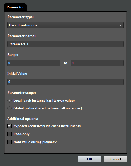

Studio 2.0 greatly expands the potential of parameters, simplifies their management, and improves their flexibility.
Edit parameter dialog

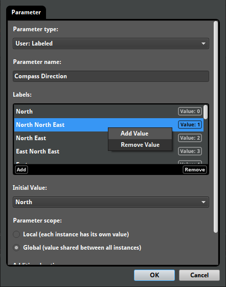

Labeled parameters can be defined when creating or editing a parameter. Insertion, reordering, and removal of labels is gracefully handled when when editing labeled parameters.
Edit labeled parameter dialog

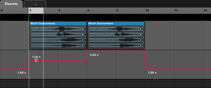

Discrete parameters
Discrete parameters use whole numbers instead of decimal values. As with labeled parameters, discrete parameters can be used to discretely align parameter content and automations.
Discrete parameter

Additionally, parameters can now be marked as read-only. This is useful for indicating that a parameter doesn't need to be set in code. For example, this can be used when a parameter should only be driven by modulation.
Read-only parameter flag

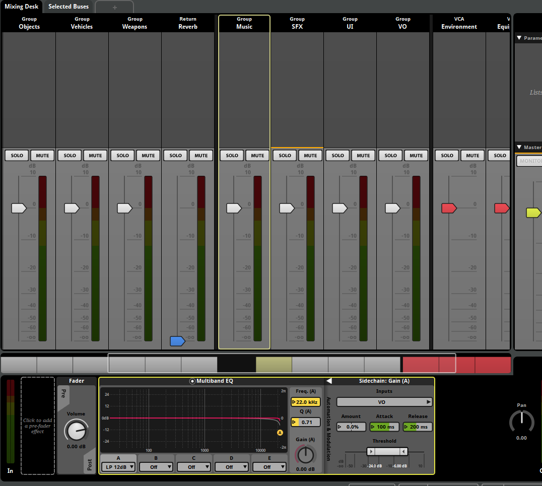

Global modulation
It is now possible to directly add modulation to properties in the global mixer. This makes it easy to apply sidechain or LFO modulation directly in the global mix.
Global sidechain modulator

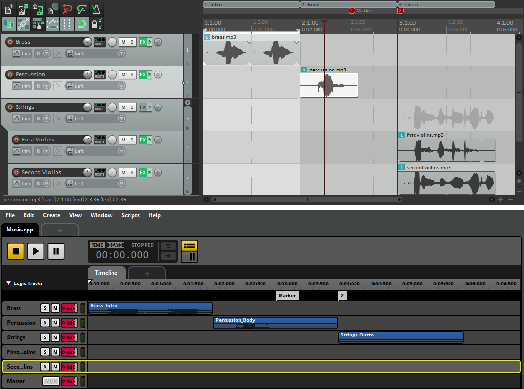

Importing timelines
It is also possible to directly import the timeline of a Reaper project as an event. This will create instruments and markers that align to the source Reaper project content.
Reaper timeline import

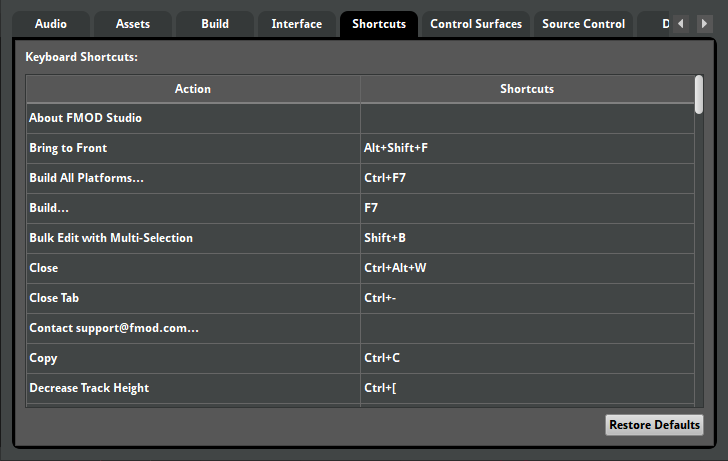

Editor workflow
Keyboard shortcuts can now be easily customized from the preferences dialog.
Custom keyboard shortcuts

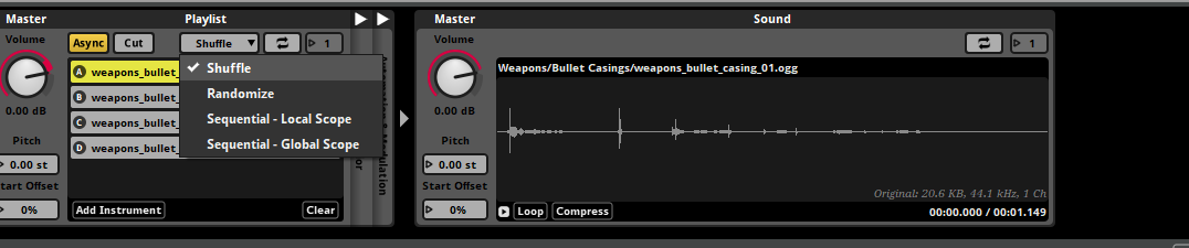

Playlists
Late in Studio 1.10, multi instruments received a number of new controls for playlists. This includes new playlist selection modes and explicit control over the loop count.
Playlist controls

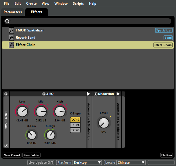

Preset effect chains
Preset effect chains are chains of effects that can be shared between multiple events. This makes it easy to manage common effect configurations throughout a project.

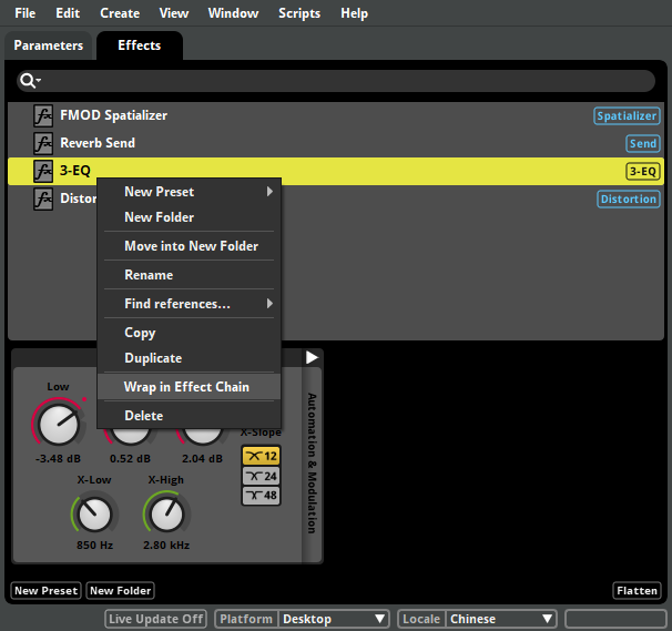

Existing preset effects can be wrapped in an effect chain through the context menu.
Wrap in effect chain

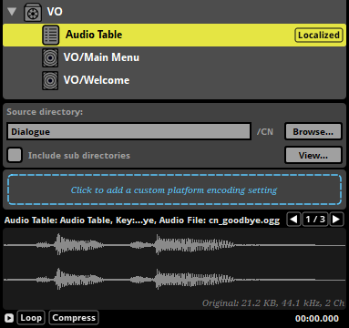

Once locales have been added, they can be used in conjunction with localized audio tables. Localized audio tables allow for asset data to be defined per-locale, which is used to create different versions of dialog banks for each locale.

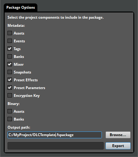

Project packaging and UGC
The "File > Package project..." menu option has been extended to allow for finer control over the data types to be included in the package. This makes it possible to export a project template for user-generated content.
Packaging a project

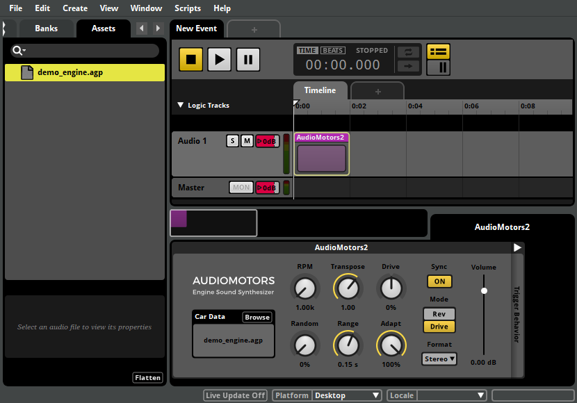

Plug-in data
Data-based plug-in properties can now be stored as binary assets in the assets browser. This makes it easy to iterate on content that requires frequent updating of plug-in data.
Binary data asset
