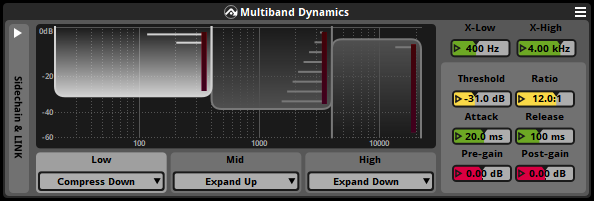

The new multiband dynamics effect is a powerful and flexible tool for dynamically adjusting a signal. With options for both compressing and expanding specific frequency bands, it can tweak a signal any way you please.
Nearly every property of the multiband dynamics effect - from the bounds of the frequency bands, to the compression/expansion ratio, to the pre- and post-gain of each individual frequency band - can be automated and modulated, allowing the compression/expansion profile of the signal to change in real time as your game runs.
For more information about the multiband dynamics effect, see the Multiband Dynamics entry of the Glossary.

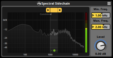

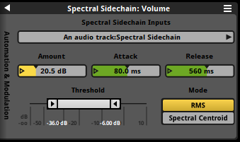

The spectral sidechain modulator and spectral sidechain effect work together achieve an all new form of modulation. The spectral sidechain effect lets you specify a specific frequency range of a signal to follow, and the spectral sidechain modulator lets you adjust another property based on the level of that followed signal.
These new tools enable a variety of sound design possibilities, from automatically ducking background walla when playing songs with lyrics and string instruments, to dynamically remixing the background ambiance to emphasize gameplay-relevant SFX, to triggering commentator barks to fill gaps in the mix.
For more information about the spectral sidechain modulator, see the Spectral Sidechain Modulator section of the Modulator Reference chapter.

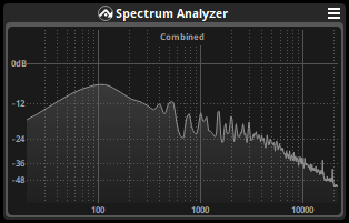

The spectrum analyzer effect is a brand new diagnostic and analysis tool. Just drop it anywhere in a signal chain, and it'll show you the live spectrum of the signal at that point. The spectrum analyzer effect is automatically optimized away whenever your game isn't connected to live update, so this benefit comes at no cost in performance.
The spectrum analyzer complements the new multiband dynamics effect and spectral sidechain modulator by giving you greater insight into your project's frequency distribution at every level of the mix.
For more information about the spectrum analyzer effect, see the Spectrum Analyzer Effect entry of the Glossary.

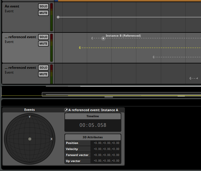

In FMOD Studio 2.03, the profiler allows you to inspect and see the resource use of individual instances of referenced events, improving your understanding of how referenced and nested events impact your game's use of resources.
In addition, the profiler window can now display the 3D attributes of individual event instances in the deck, greatly simplifying maintenance and testing of 3D events.
The new instance filtering button allows you to hide virtual event instances in the 3D preview, making it easier than ever before to see where the sound in your project is really coming from.
For more information about FMOD Studio's profiler, see the Profiling chapter.

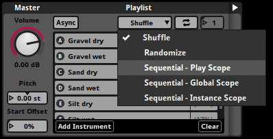

The existing "Sequential - local scope" playlist selection mode of multi and scatterer instruments found in earlier versions of FMOD Studio has been split into two new modes, allowing greater control of how your game handles event instances.
The new "Sequential - play scope" mode counts all the playlist items that have been played in the event instance since it started, allowing you to reset the count by restarting the event instance.
"Sequential - instance scope," by contrast, counts all the playlist items that have been played in the event instance since it was created, regardless of how many times that instance has been restarted since then, allowing you to make an event instance that does something new and different every time it starts to play.
For more information about playlist selection modes, see the multi instrument Playlist Selection Mode and scatterer instrument Playlist Selection Mode sections of the Instrument Reference chapter.
